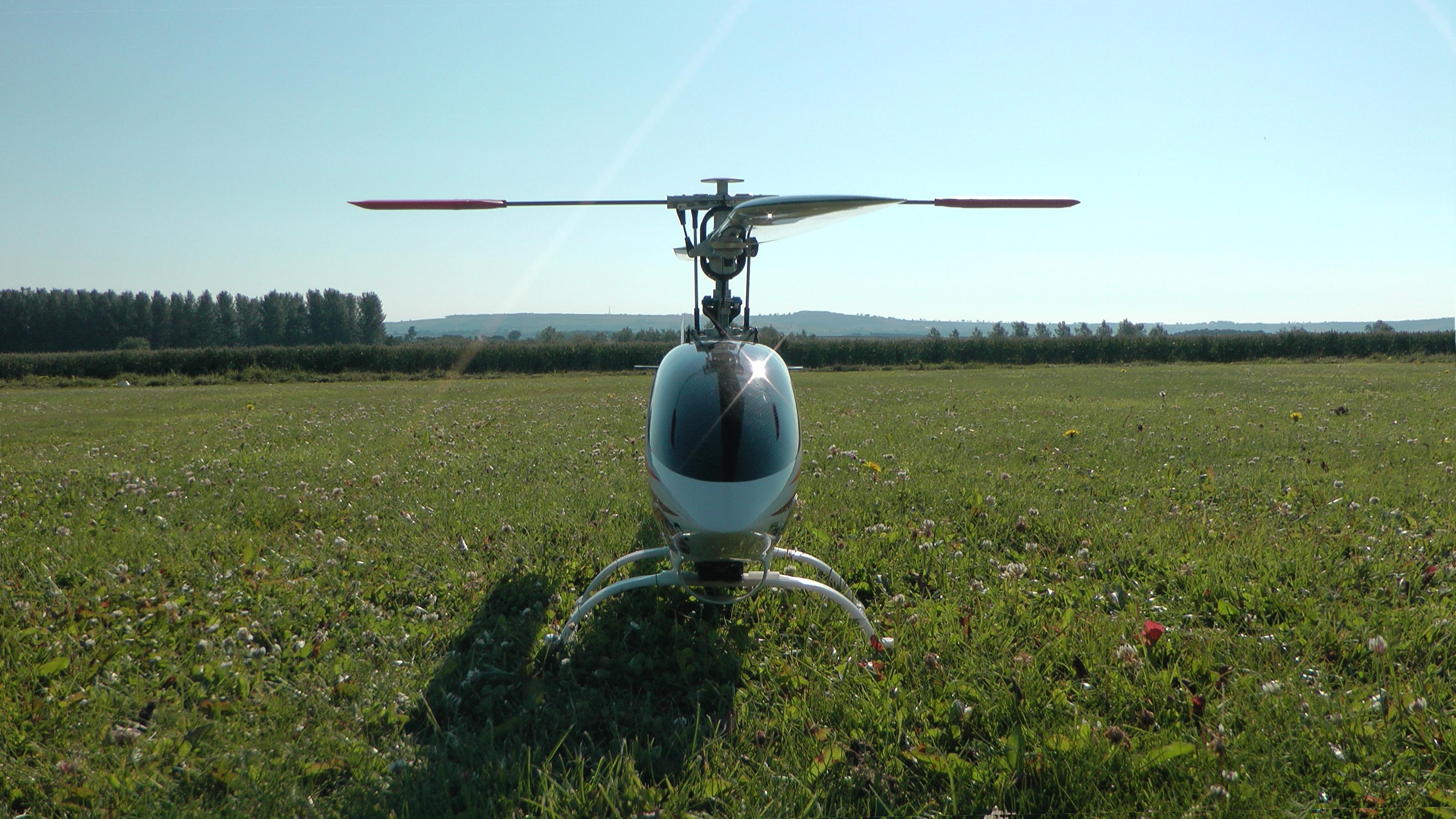

This is my personal E-Max.
The frame was designed and cut in 2009 and the E-Max Prototype still flies today with the same frame and electronics.
This is the helicopter used for Yorkshire Model Heli Tuning & Lessons.
Several refinements have been made to the production version including:
• Slimmer battery clamps to allow the sleek Raptor Titan X50 canopy to fit
• The motor has been raised a further 25mm improving the CG
• 25mm thicker area between the motor and main gear frame cutout
• A base plate has been added to stiffen the already very rigid frame
• The battery panels have been enlarged to completely cover the batteries
Specifications:
Flying Weight: 4.3Kgs
Servos: JR 8915’s on the cyclic, Futaba BLS251 on the tail
Gyro: Spartan ds 760
Receiver: RD921 2.4GHz
Tx: DSX9 2.4 GHz
Motor: Scorpion HKII 4035-400Kv
ESC: Kontronik JIVE 80+ (150A) HV (With heat sinks)
Throttle Curve: 65% flatline with ESC in gov mode
Head Speed: About 2000 but may be higher with the new batteries
Batteries: Volt-On PolyQuest Enerland 2x 6S PQ4550 XQ3 35C (12S)
Pinion: 12T Scorpion
Head: Quick UK Raptor 90
Blades: 680 Thunder Tiger Mains and 95 Torsion Tails
Frame: Carbon Core
Flight Time: 12 minutes hovering, up to 7 minutes 3D
