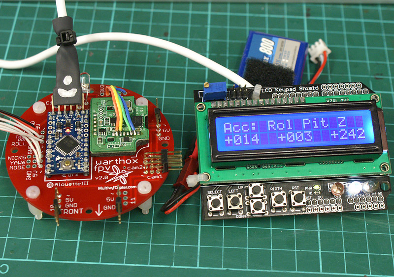

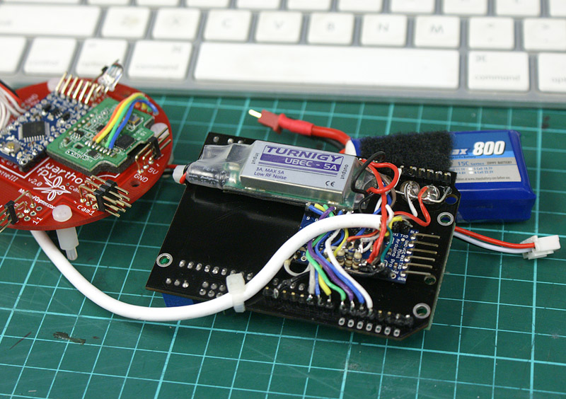

Thanks - yes I did use resistors for the three LED 330R - you can see them on the bottom view photo with the pro-mini. Your software works very well with 1.7p!

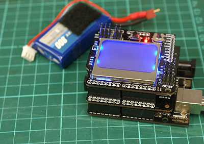

My 4884 graphic display has arrived -
now waiting for your beta version! Also to try the joystick on the 4884.
The LCD is great for quickly checking plug-n-play boards and confirm what type of copter software is installed before shipping. http://www.multiwiicopter.com/products/ ... v2-0-naked
Is there anything I can do to encourage you to work the Beta code for the 4884?

#537 Re: MultiWiiKopter-Konfigurationsprogramm für Arduino
Hi Alouette,
I'm glad to hear that v2.5 is working properly. Just in case you weren't able to translate the last posts, version 2.6beta (as well as the coming 2.6) are not supporting v1.7p(re) any more, I upgraded to v1.7prebis (this includes support for the new activation mode parameters and also battery status).
The "joystick" (more precisely, the 4-sector-push-button) on the LCD4884 should not be confused with the two-axes analog Joystick in the LCD_Conf.
This would imply to rewrite the complete application, and I would end up supporting two totally different versions. Also, I am not quite sure if the LCD4884 is as good as the 16x2 for use on the field - the characters are smaller, and the contrast is worse in bright sunlight. So chances for a migration are very low at the moment.
Well, maybe large amounts of money could do... just kidding.AlouetteIII hat geschrieben:Is there anything I can do to encourage you to work the Beta code for the 4884?
Ciao, Arnd
