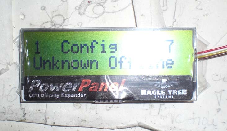

Crizz, apparently the PowerPanel is connected via the I2C Interface/Ports.

The Power Panel LCD attaches via 4 wires. Color codes and pins are in the sketch. To make it easy, I'll repeat them here:
Code: Alles auswählen
//   White wire  to Ground
//   Red wire    to +5V
//   Yellow wire to A4
//   Brown wire  to A5
Thanks!

Seems to work now... great Job, Danal. :thumbleft:

Excellent! Very cool to see that working on someone else's hardware.
