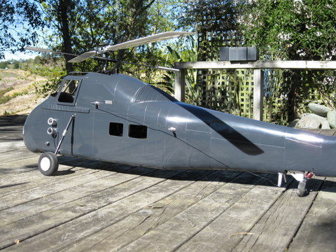

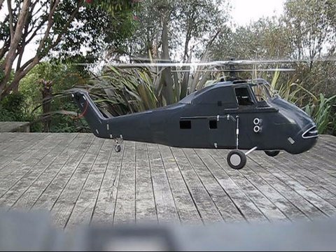

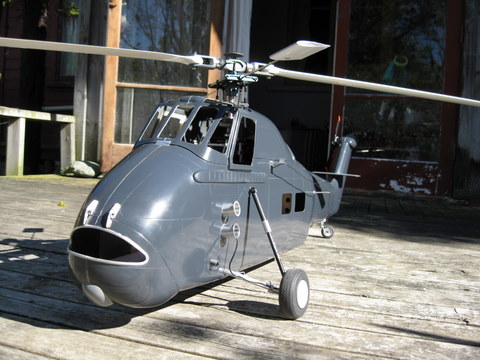

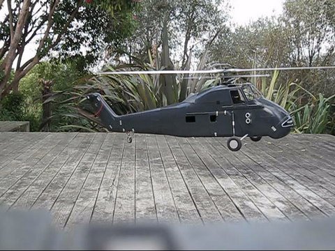

that is so cool!! just building a westland wessex has1, from scratch. here are some pics. and a utube link.. cheers gavin :D... http://www.youtube.com/watch?v=jbTw86xnzGc

:?: Do any of you guys speak any english? I am at a loss as to what you are saying! I'm on the other side of the world :)
