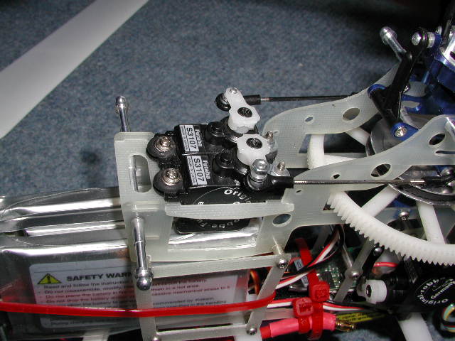

I have attached 3 pictures which should show the locations of the servos. I hope this helps.
Oliver
Oliver
- The front servos for nick and roll mounted in the front compartment
- P9290140.JPG (66.29 KiB) 1350 mal betrachtet

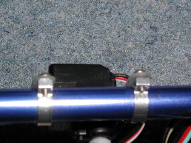

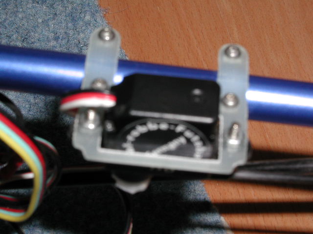

- This shows the rear servo in its plate screwed on the tail boom.
- P9290138.JPG (56.92 KiB) 1330 mal betrachtet
- Bottom view to see how the plate with the rear servo is mounted on the tail boom.
- P9290139.JPG (71.46 KiB) 1335 mal betrachtet
