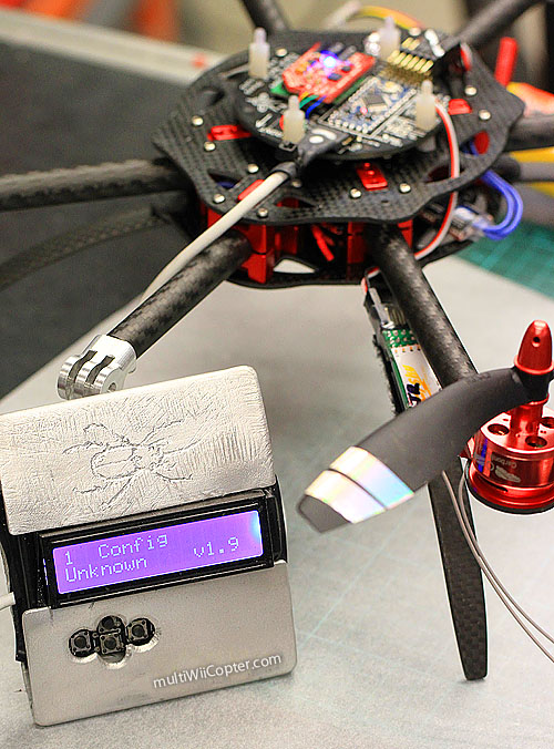

Hey Yacco
Went to use my LCD on the new 1.9 Wii code and no-go not-supported? Do you have any plans to update it?
